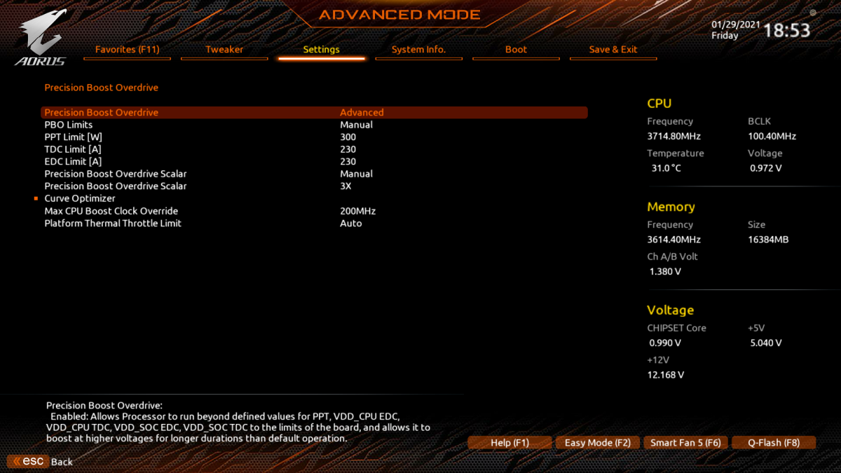

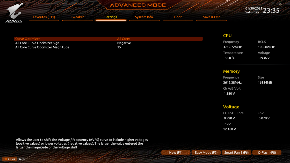

  • Овърклок – Precision Boost Overdrive Advanced, PBO Limits Manual, PPT Limit 300 W, TDC Limit 230 A, EDC Limit 230 A, PBO Scalar – Manual (3X), Max CPU Boost Clock Override +200 MHz, Curve Optimizer – 15
